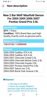

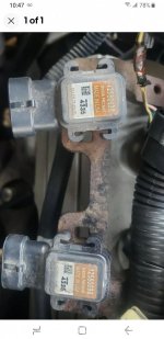

I replaced the originals with two direct aftermarket matches based on the Model #s. They are identical MAP sensors. I replaced the old ones with these ones since they were a direct match.

I did.. Started to go through checking them off one by one. I just got looking over the connections and wiring the the MAP sensors and everywhere else and taping them up. Haven't done any meter readings yet. I suspected that one place on my supercharger that was capped off needed to run into the other map sensor. That may be the one that reads Barometric Pressure so I connected a vacuum line into it. P2229 hasn't popped back up yet.. Although it did read a brief misfire but I cleared it during my drive. If that returns during travel I'll let you know ..

Mine was doing the same thing and I found the map sensor on mine was where the barometric pressure sensor was, and vice-versa so the vac line was on the barometric pressure sensor. Some say they are the same but they're not. They are different part numbers and prices. Try switching them? Maybe itll work for you.
