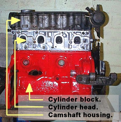

No, I have the thermostat removed on my car to protect from overheating / cooking the head. My fan is on a manual switch because the computer never turned on the fan.
I learned that some of these 2.0 OHC heads had some bad casting problems with the heads being porous .... I'll if I can find the info on that.

Cosworth ( Coscast stamped ) heads are good, Kolben Schmidt ( KS stamped) heads are the porous ones .
Same companies that made our heads.. Dont know if you are getting combustion / exhaust hitting you temp sensor through a crack or not......

This car has been sitting for over 20 years. It belonged to my son, who we lost in 2001 in an automobile accident. I'm trying to restore it in his honor. At the time, his engine was being rebuilt in a well-respected speed shop. I'd have expected the speed shop to have addressed any concerns about potential casting porosity at the time of rebuild. Also, I porosity or leakage were an issue, I wouldn't expect the symptoms to always be identical - to the precise temperature. Anyway, back to the history. I brought the engine home and it sat in my garage for a number of years before I even attempted to reinstall it. About two months ago I decided it was time to try to bring it back to life, so I started working on it again.
