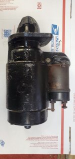

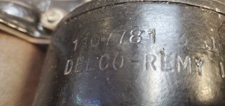

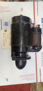

For sale is a Delco-Remy starter. It was rebuilt a few years ago, but never used. Delco number 1107781. Date code is 11/18/1963. Fits Pontiac's from 1960 to 1965. Payment through PayPal.
Asking $120.00 plus Shipping. 2020-12-27 11.56.56.jpg 2020-12-27 11.57.50.jpg 2020-12-27 12.01.10.jpg

I'm interested. It LOOKS like it will work in my 65 326. The numbers don't match, and that's my hesitation. Yours is 1107781 and I've got 1107679.
Any cross reference you have? looks like the bolt pattern is right. Do you have a pic of the bendix?
Thanks,
G
G-311519
I do have more pictures. I had this rebuilt to use on a Rambler, but discovered it was not the correct one. I searched the model number and it said it was for a Pontiac. I'm out of town right now, but I can email pictures and info when I get home Tuesday. My email is kmag1226@hotmail.com
kmag1226
Thanks for your interest. I looked into that part number, and I can't find anything that says it will fit the 326. Looks like it is for the larger V8's.
