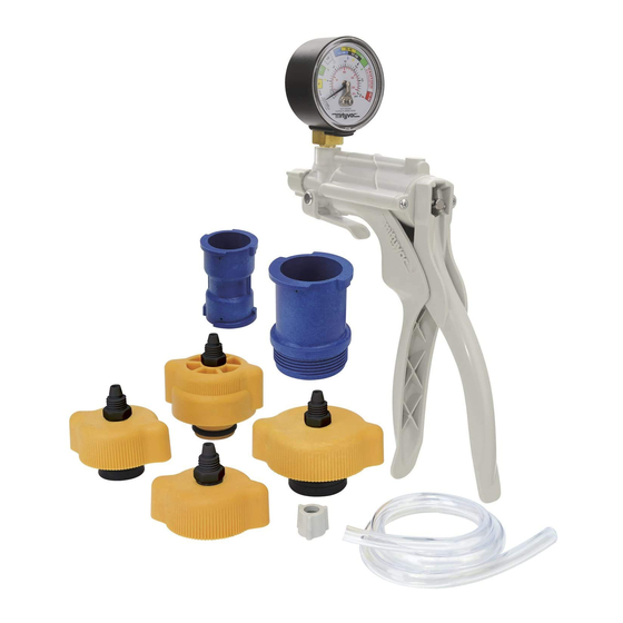

I used a Mityvac MV4560 Pressure Test Kit. According to the instructions the dynamic test is performed with the engine running. But the manual only speaks of rapid increases. I got the idea of stepping on the gas during the test from youtube videos on pressure testers, with one guy reving the engine and then claiming there is no head gasket problem. But I am not sure how accurate what I saw is and whether my results indicate where my problem is.
8. Start the vehicle engine and monitor the pressure gauge
An immediate and rapid pressure buildup is an indication of a breach between a cylinder and the cooling system, most likely due to a blown head gasket. Immediately turn off the engine and release the pressure in the system by pressing the Pressure Relief Lever located on pump (Fig. 10). Dis-connect the test equipment and replace the head gasket.
If no immediate or rapid pressure buildup is indicated, operate the pressure pump to bring the system to normal operating pressure. If the needle on the pressure gauge
vibrates rapidly, this is an indication of a smaller compres-sion or combustion leak into the cooling system possibly caused by a damaged block or head. Turn off the engine,
carefully release the pressure in the system by pressing the Pressure Relief Lever located on pump (Fig 10).
Disconnect the test equipment and consider replacing the head gasket
