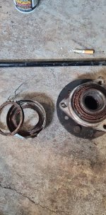

I just had to replace both hub assembly / bearings. There was 0 play in tires when trying to rock back and forth but both assembly's disintegrated upon removal. It almost sounded like an airplane taking off or driving on a rumble strip.
