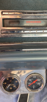

The heater mode "off-normal-rear-defrost" does not display in the mode window. Suspect the dial cord has been pulled back into the escutcheon because instructions were not followed during possible previous service, pages 1-4 and 1-5 "switch replacement" in the 1966 Pontiac Chassis Shop Manual.
Has anyone attempted to repair this assembly?
Any suggestions or advice?
Thank you!
The Old Guy
You are a step ahead having the manual. Do not recall any prior post on this.
