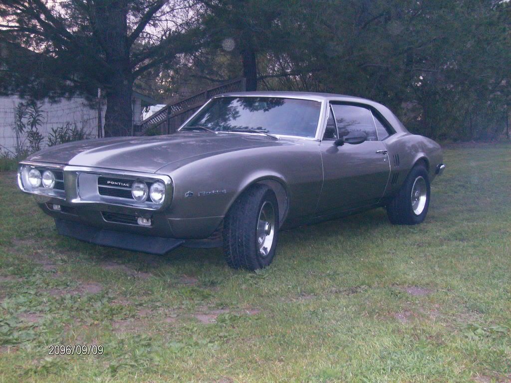

I have a 67 Bird with a straight six, but its not the OHC, it looks like a chevy straight six. Did the base model firebirds come with a chevy straight six?
The original 6 cylinders on the 67 and 68 Firebirds were the OHC six. If this one isn't, it's probably a Chevy six like you said. Can you post a pic of it?
From what I've read recently the OHC six was only used in US Pontiacs, Canadian models used a Chevy OHV six, instead. Could your car have been sold in Canada first? BTW, 1971 Camaros came with a "Blue Flame" 6 but Firebirds only had V8s.
