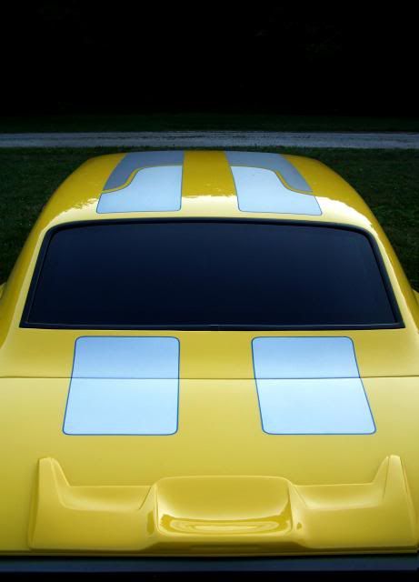

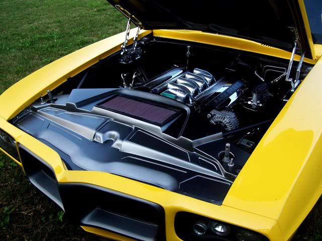

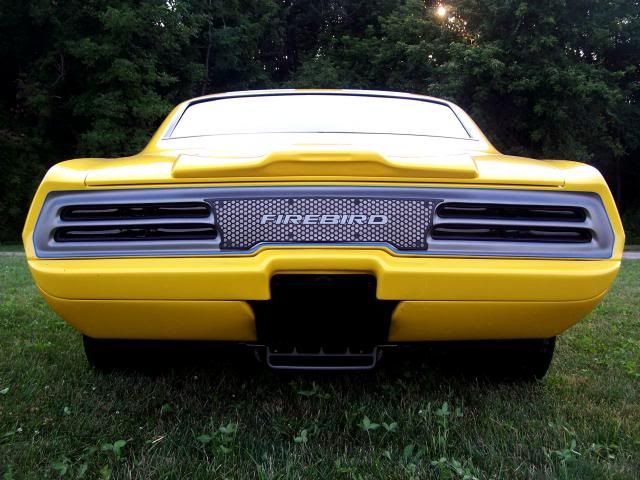

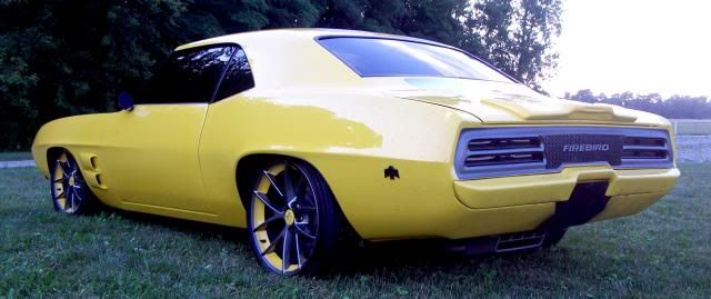

been building this for a few years, finally done. you can see the full build here I will be at the nationals in Norwalk......well here are some pics...I decided to make the ram air functional...so...it looks pretty good..the part on the car is a pattern, I will be making it nicer and making a mold for it. It has an upper part that closes down and seals to the lower....I have a few adjustments in gaps to make that I didn't have time or energy to get perfect. the wing has a third brake light in it under the yellow paint that lights up red.

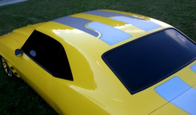

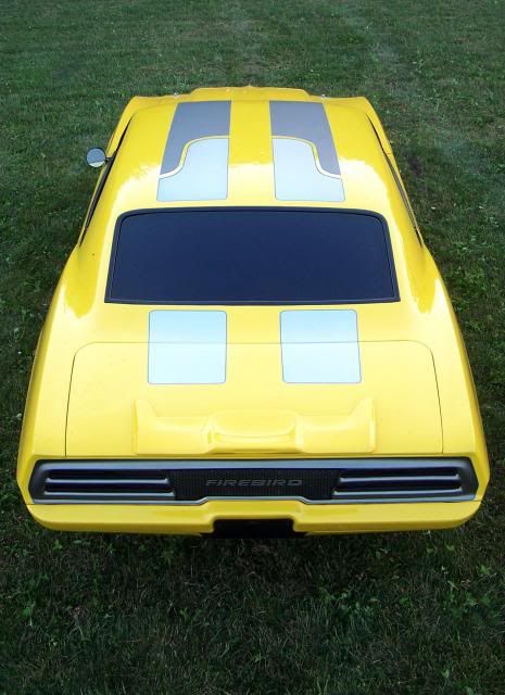

THe stripes are actually really difficult to get right. they are an optical allusion. I originally made them with a 3/4 inch gap all the way through the s-curve...but it looked like crap from behind or in front of the car...so I ended up figuring out that you have to make the ends sweep gradually to a inch more on each end and when you walk around the car the stripes change according to your point of perspective and look exactly 3/4 of an inch all the way when standing at the front or back of the car.....weird.

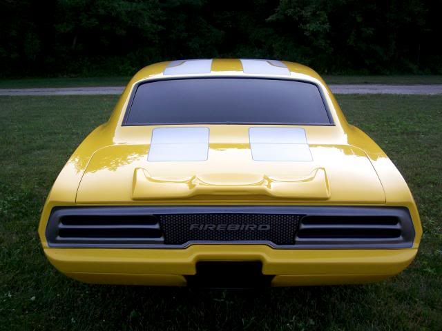

I have a mold for the wing... my idea was that the car looked good at certain angles with a wing and not so cool at others...the ends mimic the tops of the quarters where they swoop up and the middle goes with the over all shape of the rear end with the bumper and heat shield all caring a commen shape.
