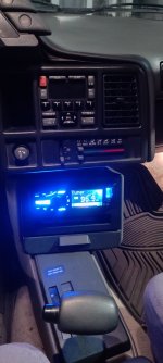

I just did mine this evening. Here's a pic of what it looks like.

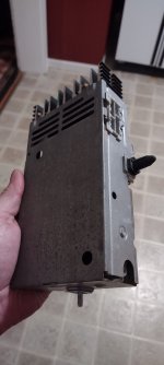

It can be a little confusing because the factory head unit in a Sunbird isn't just one single piece. The actual tuner is a gray metal box mounted vertically inside the dash, behind the radio and heat controls. It then has wire harnesses that go to the radio controls & the factory tape/CD deck.
When you take all the plastic trims off, and look through the cubby hole next to the radio, you'll see a gray metal box mounted back there. That's your tuner. Pic below. You'll need to unplug the antenna wire and the blue wire harness on the RIGHT side of that metal box. I just took the whole thing completely out, but I don't think you have to. If I remember correctly, the wire harness on the right side is the one for your speaker and power wires, and that's the one you'd use.
This was actually incredibly helpful and I've got it now after taking a second look. Thank you so much.
