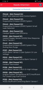

I have scanned this car and found a couple codes for O2 sensors, and a couple for EVAP system. No big surprises there, but shouldn't I have a check engine light on for these? Currently not lit... WEIRD.

Donut gasket @ manifold exhaust down-spout leaking, Introducing air to both O2 sensors. I should have remembered this triggers that.
