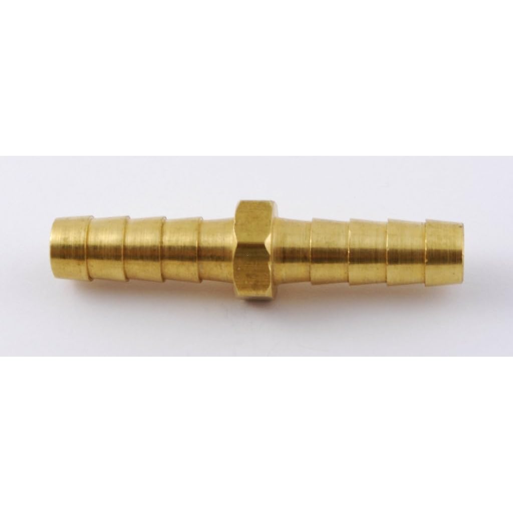

Desperate for some advice, please do not reply with “take it a profession” or “take it to the shop” because that’s not going to happen. We cannot afford it! A few weeks ago we changed the fuel filter on our 2000 Pontiac Grand Am, we ran into a little bit of a problem with the retainer clip fitting and we broke the “blue clip” (even *after* watching videos on removing it!!!) . So we bought an “adapter” which I wasn’t too sure about to begin with. It was just a hollow tube that tapered at each end so it would fit tightly into the tubing – looking it up and trying to find a link to share, I see they are called “barbed” adapters. (Very similar to this http://ecx.images-amazon.com/images/I/51J0Cb0sUsL._AA1024_.jpg ). Anyway, this is not my current issue but I’m trying to find out if it might be. We cannot get the car to start. We have checked all the fuses, checked the spark plugs, and used starter fluid. With the starter fluid it seems to advance, meaning it sounds a little better than before the starter fluid but doesn’t officially start (Like I was told it should). We have been debating with the fuel pump for a while now and I’m back and forth between believing that is the cause and not the cause. You can hear it but some say that’s a good sign and others say that’s a sign it’s louder and ‘bad.’ If you ever had one of those old cars with the antenna that goes up in the back of a car, that’s exactly what the fuel pump sounds like. We have a new fuel pump but I would hate to go through all that and that’s not the problem, I’m not so convinced it is. The only other thing we can do is get a fuel pressure gauge but if it won’t start then…I am desperate for some answers here. I’m trying to include everything I can think of but I’m sure I’ve missed something. Please HELP! Oh and I guess I should mention that it does try to turnover but doesn’t. I’m convinced it’s the fuel somewhere but I’m not sure how to tell where. Wondering if that stupid barbed adapter could have clogged that early, or what??? Feel free to probe for more information, thanks!

Silver Dak and melsg5 - no it was not running before the fuel filter was installed. We knew there was a specific way the filter was to be installed and I'm pretty sure we did not install it backwards but it wouldn't hurt to check. That's something we haven't checked yet. With all the frustration when we were changing it, it's at least a little possible we didn't think! But would it run for about a month if it was installed backwards? We did that about a month ago. I do not remember what brand it was but we got it at Advanced Auto and if you're asking because you think it might be a "lousy" one, yes we did buy a relatively cheap one - maybe mid-priced, at most.
Nevermind, one end was threaded and the other end was not so yes, we had only one option to how to install the fuel filter so that's not the case. ugh
The fuel filters have a threaded fitting on one end, quick disconnect fitting on the other so it's pretty hard to install them the wrong way unless modifications are made.
