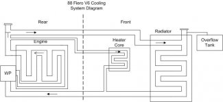

Im sure those coolant tubes to the front are clogged , might need a flush or taken off and flushed off the car.

There are 4 coolant tubes under the car that go to the radiator and heater core..., my guess is the heater core ones are restricted with buildup or have an air pocket.
Doug in P.R.
