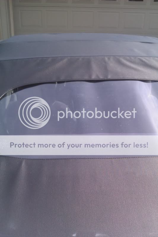

Just beware you will need two people to do this! Because of stretching and stapling! It took us a couple of days taking our time. It's not impossible and I'd reckon I saved around $1,000 having someone else do it. Here is a picture of sunshine now!
Here is a close up of the back window it is vinyl but does quite well.
