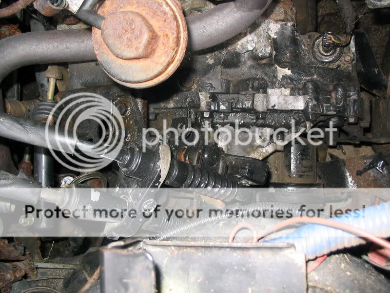

Hi, everybody. Was all set to bleed my clutch slave cylinder ('85 2.5L Isuzu 5spd.), but couldn't find the brass bleeder screw I expected to find. Instead, the slave cylinder has some kind of plastic gizmo with a cap (I'll try to include a picture). What am I missing here?
Couldn't see the pic. Just some sort of error message. I have a great pic of what I'm seeing in my car, but I can't get the site to create the attachment. :mad:I'll try again. At any rate, I've found pictures at other parts' sites, but they always show a brass bleeder. This plastic piece, where the bleeder would be, points away from the ground, toward the engine hood.
No, it doesn't look like the picture, and that's my problem (tho not my only one). I've bled brakes, master cylinders, slave cylinders in the past, always seeing a brass bleed screw. Wouldn't think a plastic one would hold up to brake fluid. Thought the plastic bit was maybe a Fiero thing. (BTW, the plastic cap turns on the plastic riser--I thought about prying it off, but don't want to make things worse. Right now, I have no movement of the cylinder piston when I push in the pedal, so, effectively, no clutch. Ergo, I was trying to bleed it.
Open to any suggestions.
To me, the plastic cap looks like a vent. Since the slave cyl doesn't move, why not remove it and trouble shoot from there? Plus, are you sure the line from master to slave is intact, no splits or leaks?
Yeah, thanks for the suggestion. I suspect the picture isn't of the clutch slave at all. I think I'll have to pull the air intake hoses and see if I can spot the real thing. Haven't had time to take things apart yet.
The picture is not the slave cylinder for the clutch. That is the shift linkage arm. The plastic cap is a bump stop for the shift arm bracket.
You can see the slave cylinder on the left side of the picture. In the picture it goes from bottom to top and you can see the bleeder on the bottom side:
(Left side of picture is firewall side, right side is trunk side)
