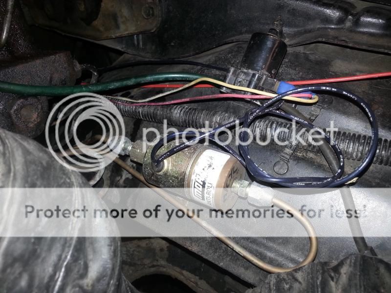

also have a pic for you to look at this is attached to the driverside inner wing and has brake pipes going to either end of it and 2 wires coming from it but are not connected to anything what is it
