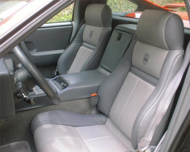

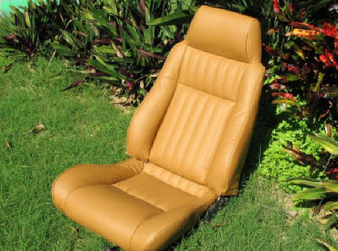

mrmikes.com sells leather and cloth covers so you can upholster them in leather or cloth. There is a wide selection of colors and styles including the 1988 factory leather seat pattern. His kits come with everything needed including new foam and the tools to do it. He also supplies a very detailed video on how to do it. You can also see the instructions on their website. Takes about 2 hours per seat and they will last a long time.
Here is what a leather set for a GT looks like:
Here is the 88 pattern:
