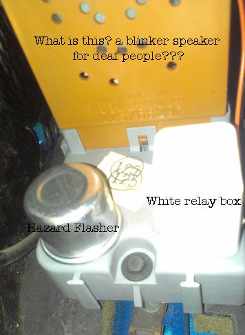

I absolutely can not figure this out. There's a panel behind the fuse box that holds two relays. One which is a two-prong little guy that is obviously in charge of hazards because I can put my finger on it and feel it clicking when I turn the hazards on. However, there's a white box relay right next to it that I can't tell what it does but I believe it's a 3 prong. I pulled the cover and cleaned the contacts but that did nothing.

Pics of the hazard fuse and the white box fuse, and also a picture of my column area with the cover off. And apparently the forum won't let me upload pictures even though they are the right size. Grr.

Ravie, just went outside to see where it is ..........Its located to the right of the steering column under the heater control/ upper console interior plastic.
Its hidden good ,cause I cant even see it but can hear it. Looks like you have to take stuff apart ( lower heater interior plastic and/or the upper console plastic - where the factory CD player would of been). Big metal bracket is in the way to see it from under the column.
In your first pic.....that big rusty metal bracket on the right ........... its on the other side of it .
All I can say is .....................have fun !:p
Doug in P.R.:cool:
Doooouuuggg! You fricken win, my friend. Seriously, if I could buy you a beer.. What in the H E double hockey sticks were those engineers smoking? Yeezuss.
New one is in, and the blinkers work just fine like they should.
