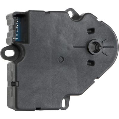

It's located on the passenger side of the HVAC unit under the dash below, and to the right of the glove box. Part # 16 in this diagram is what you're looking for.
http://www.newgmparts.com/parts/200...teid=213815&vehicleid=1359312&diagram=FQ99060
The actuator looks like this:
