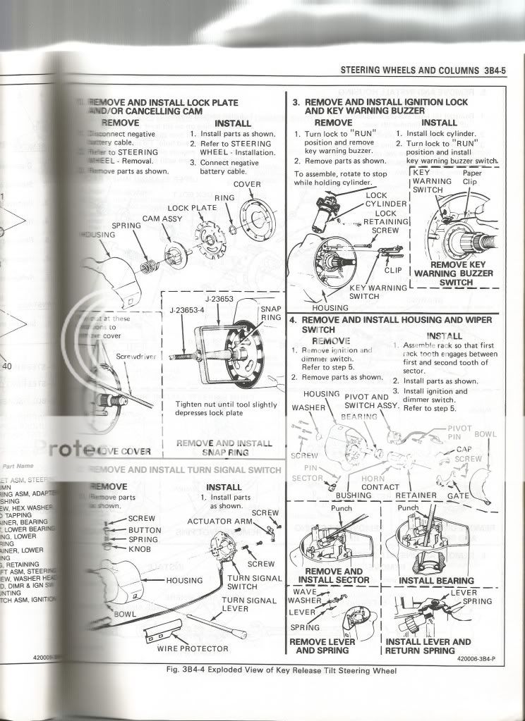

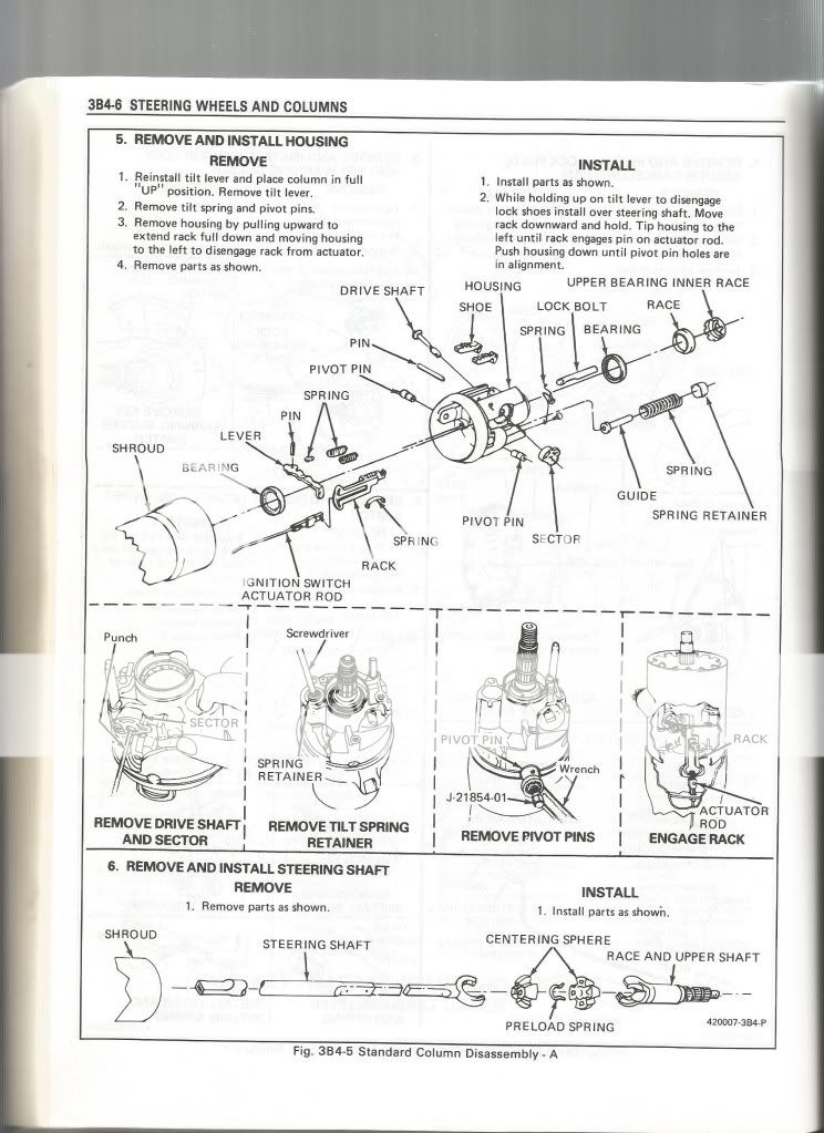

Best I can do for the housing;
The rod attaches to the high beam switch, located on the lower steering column.
Good luck
you know. i have a haynes manual.. never occurred to me to look.. -_-
