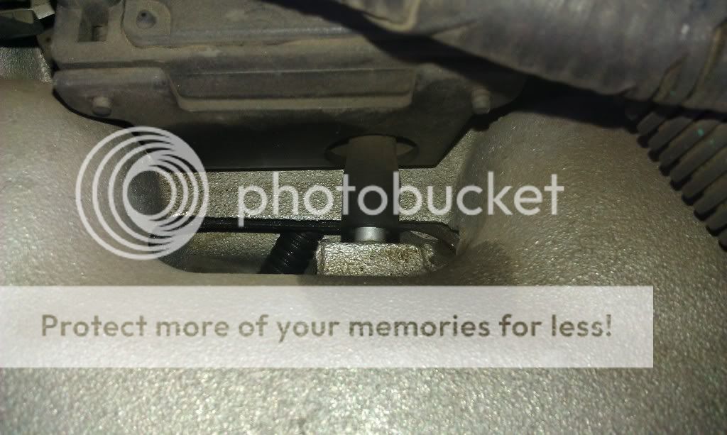

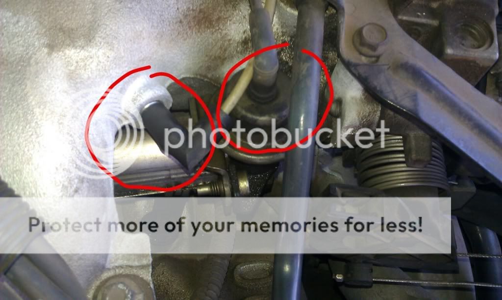

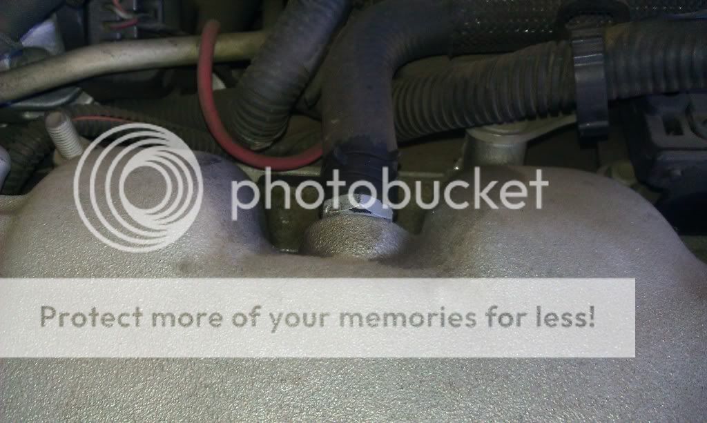

When I sprayed these four spots carb cleaner, the engine revved higher for a sec:
The two I circled above looked like they were part of the wiring harness?? Not sure why it would effect the rpms when I sprayed there...
Does this make sense? Not sure how to proceed yet...
Do you have a check engine light on? Did you pull the vacuum line off the fuel pressure regulator and check for gasoline? If you see gas the regulator needs to be replaced.
