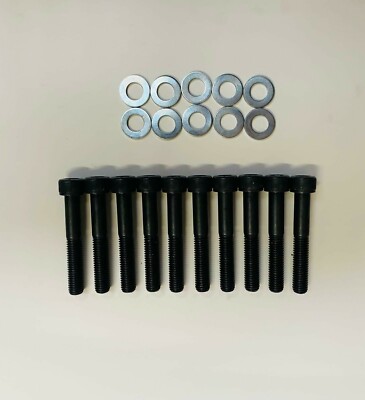

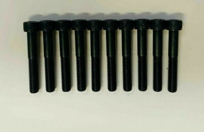

These are 75 mm , 65 mm are also available....
Doug in P.R. :cool:
You could just size them up at a local bolt store and get them there. As as long as they are the same hardness , size and length.
The Cadillac guys do it since you can't buy them new anymore other than ARP which are expensive.
