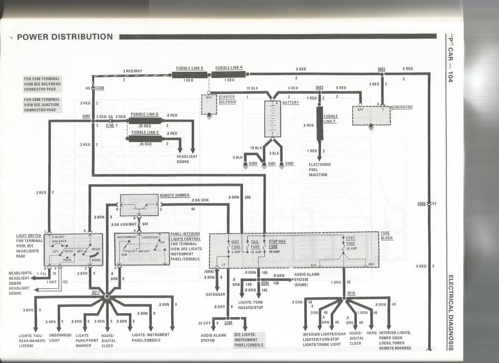

well I dont have a diagram for your electrical system but on many older cars the postive cable runs to the starter and from there the other circuits are fed. Do you have a wiring diagram for your car so that you could trace from the positive cable on the battery?
I have a haynes manual. I'll check it out tomorrow when I go to the garage again ( cars at my garage not here).

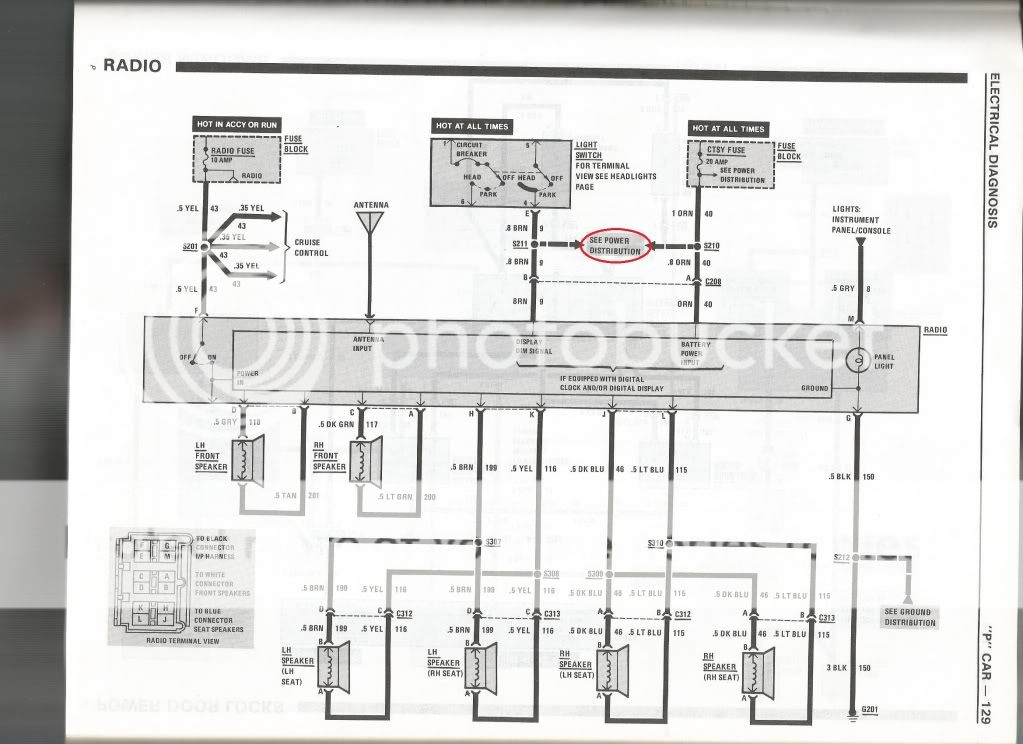

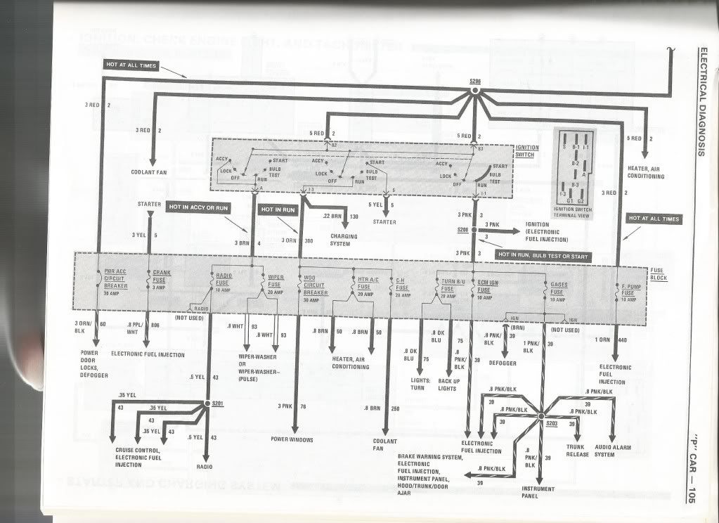

These may help;
http://i1147.photobucket.com/albums/o549/glake89/Scan0005.jpg
http://i1147.photobucket.com/albums/o549/glake89/Scan0006.jpg
