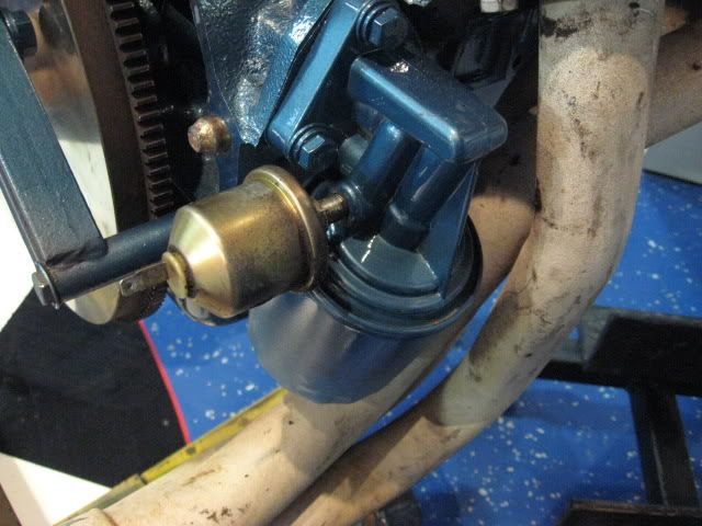

Did you read post #4 above? You do know where the oil filter is and can see the oil sender above it? The picture below shows the large sender used with a factory pressure gauge.
http://i183.photobucket.com/albums/x166/judge1971/IMG_0942.jpg
Yeah I see the oil sender. What do I do from there?
If you want the factory light to work you remove the sender. Take the sender and the last fitting on the nylon line and take them to an autoparts store and ask for a "T" adaptor. You screw the adaptor back into the oil filter mount and screw the sender into one hole of the fitting and the fitting for the nylon line into the other hole.
