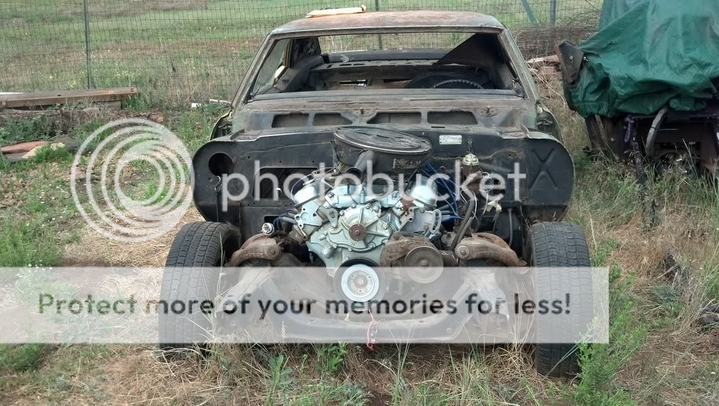

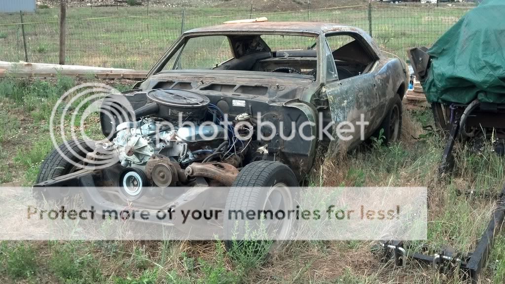

My name is Dave and I just picked up a 1967 Firebird that was a stalled project.
It is originally a Sprint Six 4bbl 3 speed floor shift car. The PO had purchased it in 2002 with a leaky, smoky Chevy 230 in it.

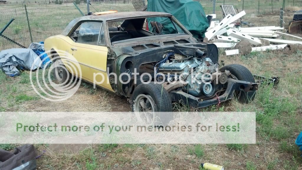

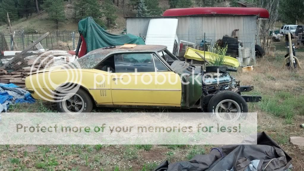

He was very excited, bought the full PHS document package, did a bunch of research, ready to do it right. It was originally optioned like this:
He then disassembled it, planning on a restification (body restoration/performance modification) of it. He bought a 325 horse 389 from a ’66 Bonneville and had it rebuilt. He sold the 3 speed and bought a BOP TH350. He started stripping paint and purchased some replacement sheetmetal, and then the project stalled. It sat in his garage for 8 years, then in his field under tarps for 2. Now it is mine.
I am not a body guy, so that part is being farmed out. I am dealing with the mechanicals. The receipts on the 389 show all the parts and work completed. It was taken .030 over and the crank did not need ground. He used cast 9.5 pistons with a Crane H-272-2 camshaft. The Carter AFB from the Bonnie has been rebuilt, and he added Hooker Super Competition full length headers. I have a TH400 that will be going in this. It has 3.55 gears in the rearend right now.
I’m thinking with a 25-2800 stall, I should have a decent street/strip car that can be driven daily.

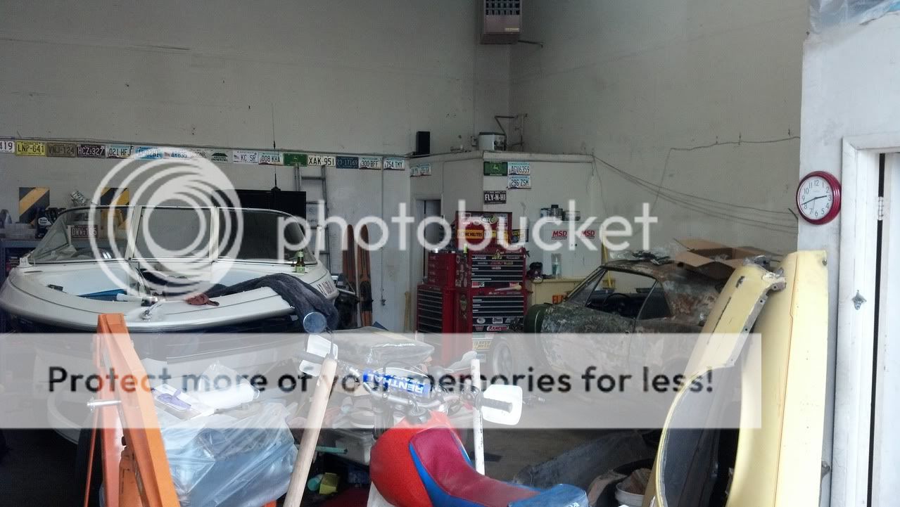

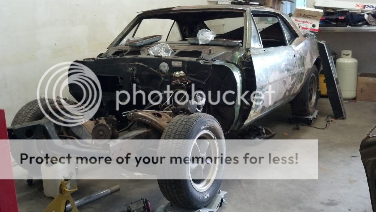

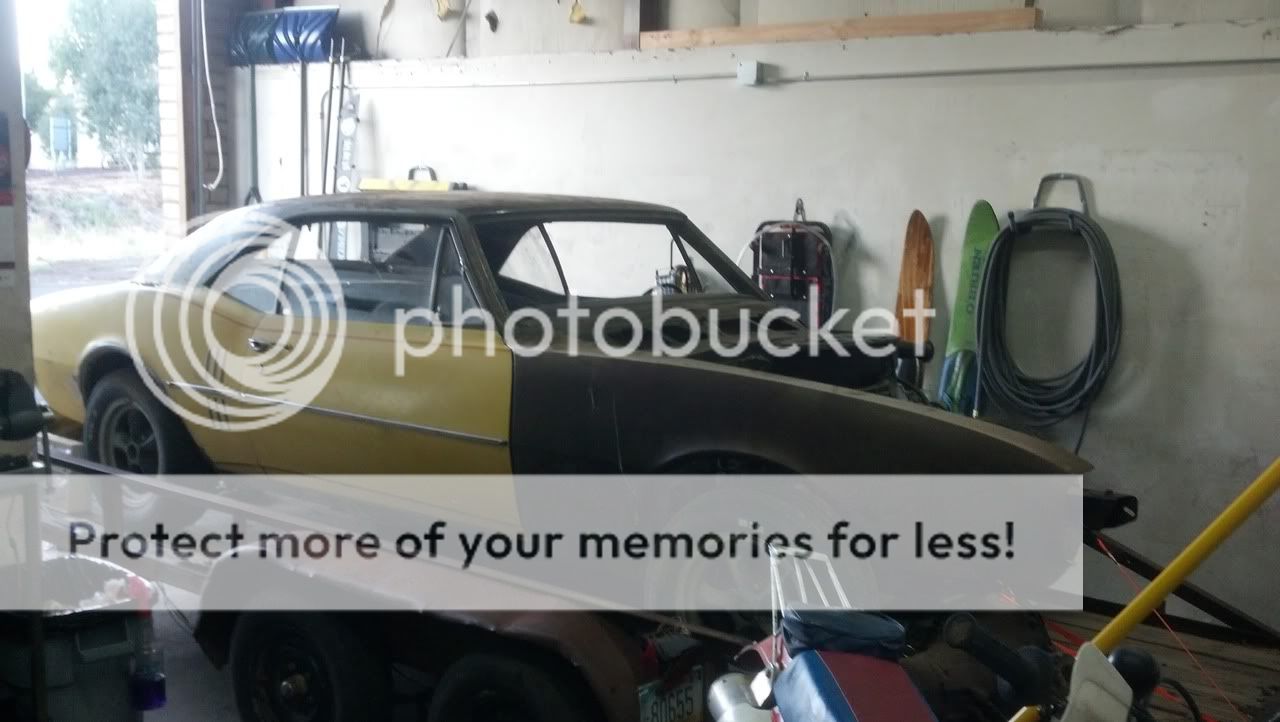

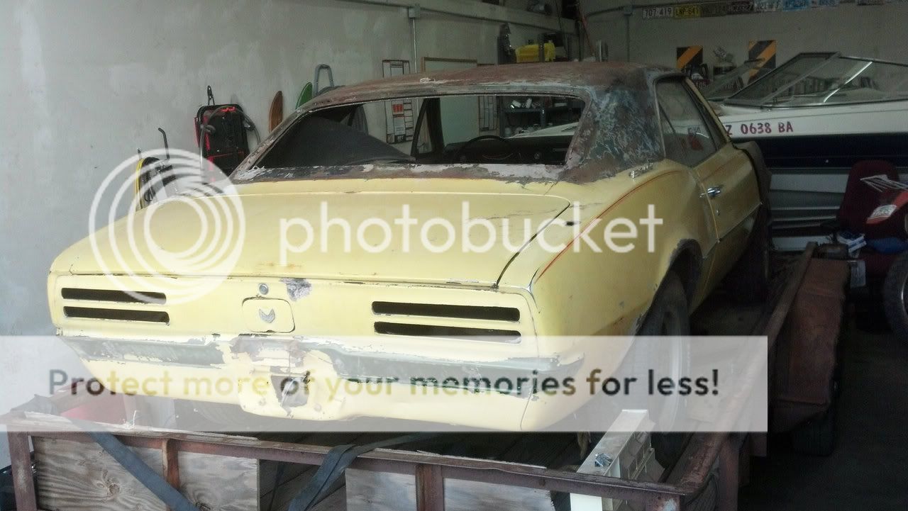

I went and picked it up, pulled the engine, and on Friday afternoon, my new dollies showed up from Harbor Freight.
On the trailer:
On the dollies:
She's in there somewhere:

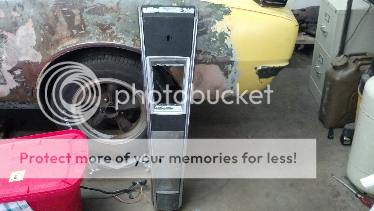

I started to take inventory of all the parts. There were a couple pleasant surprises. Hurst Pro-Matic 2 shifter, center console, some new sheetmetal, hood insulation kit, etc.
I think these will be staying....Why advertise?
