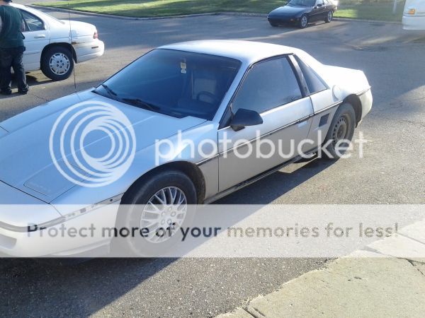

1st post.
I just got an 87 yesterday, and Im missing a couple things, i was hoping maybe you guys had one, or knew where to find it. I need the drivers side reflector and trim that goes on the front fender. Been looking everywhere. I managed to find a right one somewhere, I found a tail light, and the right rear quarter marker, but no luck on the front left.
Sometimes it doesnt want to go into gear. (4 cyl, 5 speed). You sometimes have to let the car roll a bit, and give the stick a good hard shove into gear. Any Ideas why?
The other thing, you cant drive it past 60mph without feeling like the back of the car is going to spin out from under you. Truthfully, its downright scary. I looked it over, and it doesnt seem to have anything really loose, however, there is some play in the rear tie rods. No crash damage.
If you guys could help me out here, I would really appreciate it.

EDIT: oh and you have a SE its more of a GT notch back style.

The hard into gear could be off alignment for gears.
Swaying after 60 is quite possibly an off alignment get a 4 wheel alignment.

I think the inner rear tie rods are junk. I jacked it up and could move the rear wheels laterally. No doubt it will need an alignment.

Couldn't see more than 5-10$ each, I don't know if they work or not though due to being pulled from the yard. Don't forget shipping. As for Tie Rods mine are same way I have a little play thought it was bushings but im getting it aligned first as thats a common problem with 4 wheel independent suspension.
