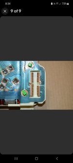

No wires---copper feelers aka fingers on the cluster, plastic copper inbreded circuit board... disaster.! Had to replace my cluster..

Here are the fingers I was talking about, the wire connector gets plugged into these ....they get corroded sometimes....
