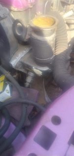

Hi guys can somebody point me in the right direction please?
I am looking for a Thermostat housing for my sunbird, the part with 3 screws, triangular shape, I can't even find a picture of it online.
and I need shipping to Europe
it should fir this type of Gasket shown in picture

worst case scenario, can i leave it as is with a thermostat cancelled ? it was removed by the previous owner
There is another radiator cap on the driver's side of the radiator, but it's hidden and you have unbolt the radiator to access. You can fill the coolant there.
Here's the junkyard in Canada with one: Oliver Recycling & Salvage LTD | Oliver, BC
I sent two parts pullers in Canada pm's but they never answered .( Sunbird in another British Columbia upullit)
I run no thermostat down here, just depends on your temperature where you live. Here it's hot and I have my fan on a manual switch to regulate temperature because I almost cooked the cylinder head/ head gasket.I'm also adding another fan that comes on automatically at a certain temp in case the other fan fails. ( The factory computer stopped turning the fan on)
Is your housing rotted out ?
You can Fab up a pipe or something to connect the hose to the block.But it has to be as high as the original one to get air out of the system.
