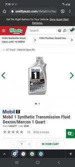

Everyone knows my car..it's time for a trans fluid change and looking for the type and quarts..will this be fine to use??I love full synthetic product's..

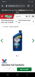

Is this ok for my car.. mobil 1 full synthetic is all I use in my car's and would to use this of it's ok to

Anything that says Dexron is compatible with your car.
