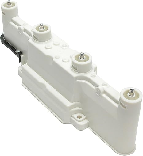

I have a 2001 grand am with the 2.4L twin cam motor. It is misfiring. Live data on the scanner is showing majority on cylinder 1 but #2 is also misfiring. Plugs look fine. Since this motor has 2 coil packs, 1 pack fires cylinder1 and 4, the other pack fires cylinder 2 and 3. I'm thinking it might be a shorted ignition housing since there is carbon markings on the tips and a crack. anyone have this motor and dealt with this?
