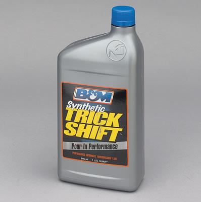

About 125,000 miles on the car, and the transmission has just been noisy, after reading the Tech Service Bulletin to increase the fluid from 1.8 qts to 2.6 qts, I did an internet search and found others have had the same problem and one guy did a test of various fluids and amounts.
I put in 3 full qts of B&M Trick Shift Auto transmission fluid. I can say the car drives smoother and the transmission is smooth.
I wanted to just share my findings.
This is the brand.
thanks for the post, I assume you are referring to a manual transmission
Yes meant to include that in my post, a manual 5 speed getrag transmission. T
