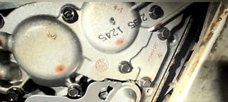

Hello everyone! I've been working on my 06 GXP for a few days now. Last month the temp was -10⁰ when I started it to take my kids to school. It didn't make any unusual sounds just high idling due to the cold. It put it in drive and no forward movement. Turned it off, started, and had forward movement for 1/2 block then no forward movement again. I reversed back home.
I immediately brought up my code reader app, FIX'D, bank 1 sensor 1 needing replacing. Replaced that a week later. Still nothing.
Last Wednesday I dropped the transmission pan, changed the seal ring, and transmission filter and noticed this.
My question is, is this normal? Judging by the lines, this does NOT look like the 4t65e lines that I've seen in the handbook. Any idea if it is or isn't the 4t65e?
Thank you!photostudio_1647843575770.jpgphotostudio_1647843524851.jpgphotostudio_1647843374723.jpg
GXP came with 4T65-HD transmission
That's what I was thinking....the transmission filter that was in it shows 4T65E & 4T60E. I'll attach picture of the old filter
