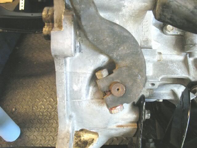

Since "no engagement" started after replacing the slave, Have you had someone push the clutch pedal while you watch the slave cylinder? The slave pushes an arm for the clutch. If the slave isn't pushing the arm or not pushing it far enough then the problem is not in the transaxle. How did the bracket for the slave look? I've seen some that were cracked so when you pushed the clutch pedal, the slave cylinder moved as well which caused the clutch to move very little or not at all.
Another thing to check is on the clutch arm on the transaxle is a bolt holding the arm. If it was put in backwards with the nut facing the case, This will limit the arms movement.
Here is an incorrect bolt:
Here is what it is suppose to look like:
